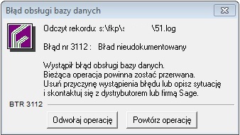

proszę o pomoc w sprawie załączonego błędu.
Sprawa dotyczy FK2014.d
Będę wdzięczny za pomoc w tej sprawie.
BłądFK.jpg [ 30.38 KiB | Przeglądany 3843 razy ]

problem z gatunku sieciowych.
3112: Failure during receive from the target server
The Pervasive Network Services Layer attempted to receive data from
the target server and encountered a network specific error. Check the
Pervasive Event Log (PVSW.LOG) for more information.
Note If there is a problem with AutoReconnect, a further status
code 3131 will be issued.
You may also receive this error under the following circumstances:
When using only the NetBIOS protocol with a remote
Workgroup engine, the client is sending more bytes than can fit
into the engine’s network read buffer. Go the machine where the
remote Workgroup engine is installed, and try increasing the
value of the configuration parameter, Server Communication
Buffer Size Read Buffer Size.
Trzeba sprawdzić co jest nie tak z komunikacja sieciową stacja<>serwer.
